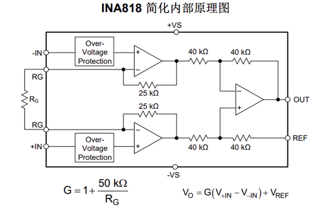

Hi Team,
Customer would like know what's the benefits of TI Instrumentation Amplifier? Compare to use Precise Amplifier and Current Sensing Amplifier to build the same circuit. Thanks in advance.

Hello Francis,
Please see the following video that compares an instrumentation amplifier to current sense amplifiers.
