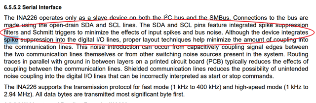

Hi Expert,
My customers would like to know the detailed parameters of noise spike function of INA226.In the datasheet it mentioned that there is a integrated spike suspension filters. According to I2C protocol, the noise between 0-50ns noise should be filtered out by the noise spike function in fast mode, so the questions are:
1. Can INA226 support this noise spike (0-50ns) function in fast mode?
2. Can INA226 have noise spike function in standard mode?
