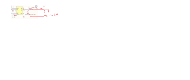

I want to drive the LMH13000 with a TTL input.
How should I configure the LMH13000 TTL interface circuit?
The TTL signal is 0 to 3.3V and operates at 10MHz.

Hello , please use LMH13000 as attached to be compatible with TTL.
Also i request you to dismount C2 ( this is has nothing to do with TTL , just a feedback on schematic )
