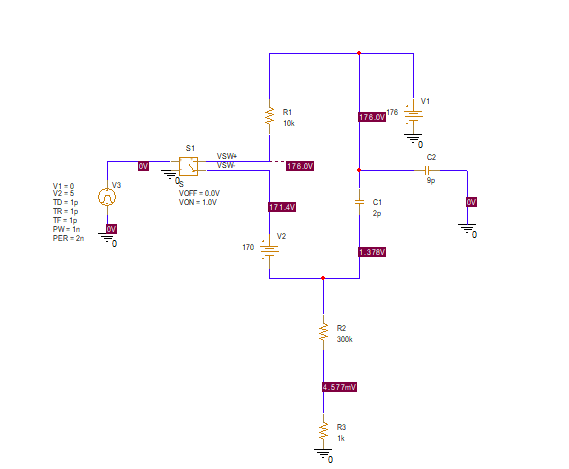

   Who can solve my issue . It seems that the switch doesn’t work fine if the input pulse is set in the nanosecond range. How can I change the settings in Options so that the switch operates correctly in the ns range?”

  • Hi Peter,
    I don't see how the second plot is indicative of the switch not working. If you are using the correct model, the PSpice voltage-controlled switch has the switch resistance according to the following equation:
    In the second simulation, you are changing the control voltage pulse width such that it will take longer for your probed voltages to reach steady state.

  • Hi Peter,
    Below is the circuit:
    Below is my simulation. The top plot is the switch resistance. You can see that it swings to my defined RON and ROFF (1Ω and 1MΩ). The bottom plot is your probed voltage. You can see that it settles with a low ripple (because your switching frequency is much higher) at around 0.2us.

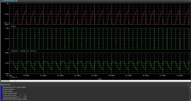

  • Dear HO SIU,
    To clarify my request: I’d like to see the response shown below when the input pulse has PW = 1 ns and PER = 2 ns. Alternatively, for TD = 0, TR = TF = 0.1 ns, PW = 0.8 ns, and PER = 2 ns, how should I set up the simulation to obtain the same result?
    When the input is configured with PW in the microsecond range, the response operates correctly. However, when PW is reduced to the nanosecond range, the same result is not obtained.
    Do we need to set more options? Anyway, I already tried .OPTIONS RELTOL=1e-4 ABSTOL=1e-12 VNTOL=1e-6 METHOD=GEAR RSHUNT=1e12 GMIN=1e-12, but it still didn’t work.

  • Hi Peter,
    This circuit and simulation are lacking context. Could you please describe the goal of simulating this circuit? What is this circuit trying to model exactly?
    I'm a little confused as to why you expect the same circuit to have the same output response for different inputs. When you change the period of the pulse source, you are changing your switching frequency. The capacitors need to take time to charge, and you are no longer fully charging them before the switch changes state. That is why it takes time for your probed voltage to settle.
    The only way to get a similar response with the higher frequency input would be to lower the values of the energy storage elements in your circuit such that they fully charge and discharge during the duration of your 1ns pulse width. I lowered the values of the capacitors by a factor of 1000 an obtain the following result:
  • Dear HO SIU,
    Thanks, I get your point. This is an APD (avalanche photodiode) model simulated while the device is operating in Geiger mode, so C1 and C2 cannot be changed, as they represent parasitic values inside the model. In case you need to design it for nanosecond operation, what are you going to do?.
