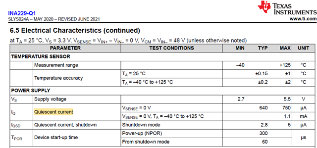

There are two parameter: operational current is 640uA in first page and IQ=640uA in page 6. So whether the 640uA is active current?

Operational current and quiescent current are the same thing. There are other different currents such as bias current but in this case operational and quiescent are the same.
