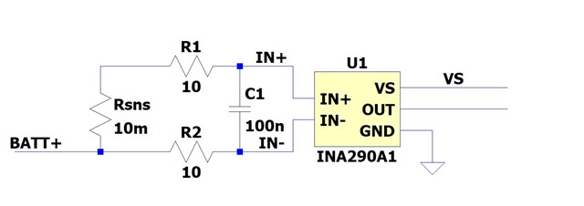

I am planning to use INA290-Q1 /A1 Device) as current sensor
In some cases there will be 40V at IN+ and IN-, but no voltage at Vs, the voltage difference between IN+ and IN- (Vsense across sense resistor) will be 0V
If I look at figure 6-15 in the data sheet, I would have assumed the input bias current into IN+ and In- would be close to 0uA
But in Spice simulation and in real life, the bias current into IN+ and In- is approx. 39uA each
Please clarify how I miss read the datasheet

    To confirm: there is a VCM of 40V, but there is no current flowing through the sense resistor? Can you please share a schematic of your board or image of your Spice model?
    You are correct, if the supply is 0V and the Vsense is 0V then there should be an IB ~0uA.
    I would recommend you run a test (or share the scope shot if you already did this):
    Step Vs from 0V-5V and monitor the Vsense, IB, and Vs. Then step the supply back down to 0V (5V-0V) and monitor the same voltages and currents.
    Holly

    I have attached the Spice simulation schematic and test result.
    As you can see the IN+ and IN- input current is not 0uA but approx. 19uA
    BATT+ is steady 32V
    VS is steppe from 0 to 5V
    In my last simulation I must have done something different to get 39uA

  • Hi Henrik,
    This looks like a limitation of our spice model.
    Do you have any results from your real life test that you can share? I would like to see the same measurements: VS, IB, and Vsense.
    Holly
