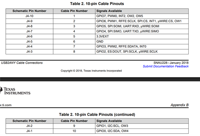

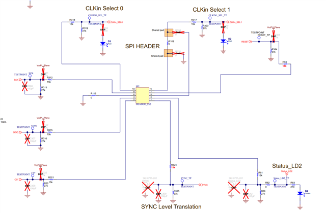

I am working with a CLK104 RF Clock Add-on Card (UG1437) and want to program it using TICS Pro via the TI USB2ANY interface.
At present, I am wiring from USB2ANY (J4)CLK104 (J33) with the following mapping:
  • SDI: J33 (4th pin) → J4 (10th pin, SDA)
  • SCL: J33 (8th pin) → J4 (9th pin, SCL)
  • GND: J33 (6th pin) → J4 (6th pin, GND)
Could you please confirm:
  1. Whether the above wiring is correct for I²C communication between USB2ANY and CLK104?
Additionally, after performing the above wiring and attempting programming, I am not seeing the expected outputs at the ADC_REF_CLK_A/B and DAC_REF_CLK_A/B.
Any guidance or example configuration would be very helpful to validate whether this is a wiring issue or a configuration step I may have missed.
Your support and example references will help ensure correct setup before proceeding further with TICS Pro programming to CLK104.
