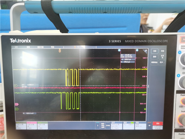

We have found that use CS0 (connected to 8-wire NAND flash) and CS1 (connected to 4-wire NOR flash) may result in chip selection conflicts, as shown in the waveforms of CS0 and CS1 in the following figures.
After replacing the TI EVM with CS0 (connected to 8-wire NAND flash) and CS3 (connected to 4-wire NOR flash), it works normally.
Why do CS0 and CS1 have conflicts.
    If you see both Chip Selects going down at the same time, my follow up questions are:
    1. Do you see this while booting?
    2. Do you see this while performing a Flash operation(Erase, Writes or Read) on one of the Flashes via a single chip select(CS0/CS1)?
    Looking forward to your response.
    Vaibhav
    1.During the kernel startup process, the measured cs0 and cs1 were simultaneously pulled down
    2.There is no problem using CS0/CS1 alone, it can be erased, written, and read normally
    Is it on a custom board? If yes, what else is connected on chip selects?
    Also, what steps you are performing to switch among chip selects?
