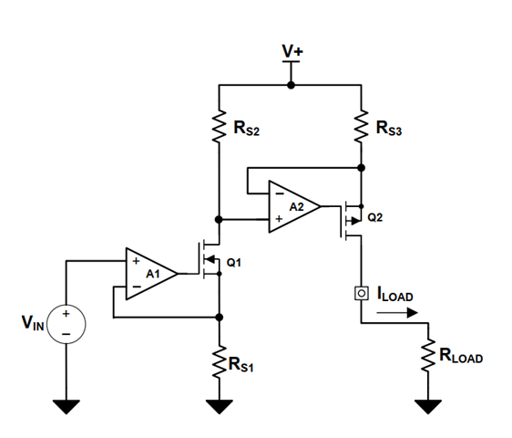

How to expand the output current to be bipolar? Can it be modified to be bipolar on this refer circuit?
Hello User,
Howland current pump.
Without buffer https://www.ti.com/lit/pdf/sboa436
With buffer https://www.ti.com/lit/pdf/sboa441
