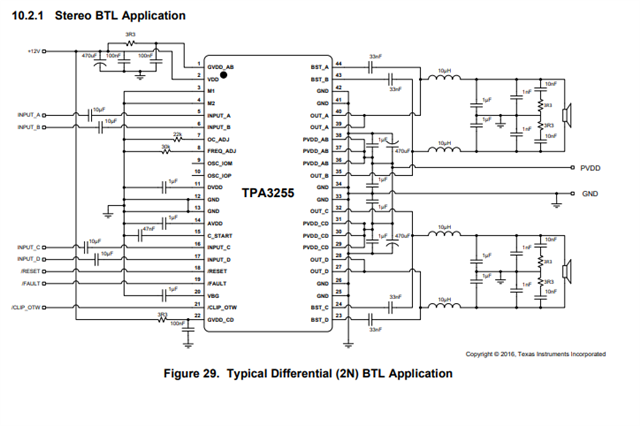

Is two BTL connections with this part possible?
TICSC
Hi
please refer to the datasheet 10.2.1 Stereo BTL Application.
