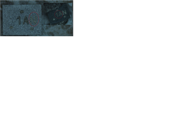

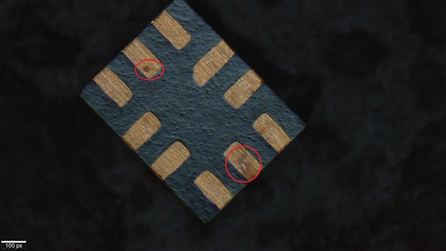

Is it acceptable for such defects to appear during production?
- differences in marking style with the same date/batch code, color change and plaque on terminals, damage to terminals.

Can you please tell me where you received these parts and how they were stored?
Are datasheet specifications still being met?

"Scratches and some indents are allowed to a certain length/depth.
The most important thing is that your customer is able to reflow the parts - if that is okay, then it is safe to use."
