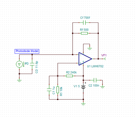

HI,
Using the following bias circuitry:

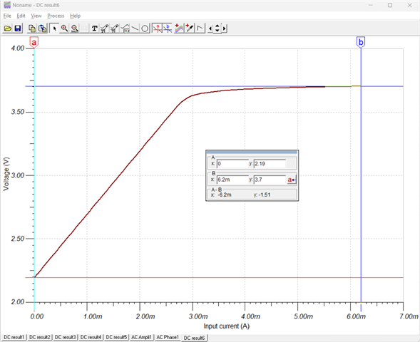

If I look for the DC Transfer function, I obtained the following graph:
I expected 5*10k/(10k+240k)=5*10k/250k =0.2V at x=0.
Am I missing something?
