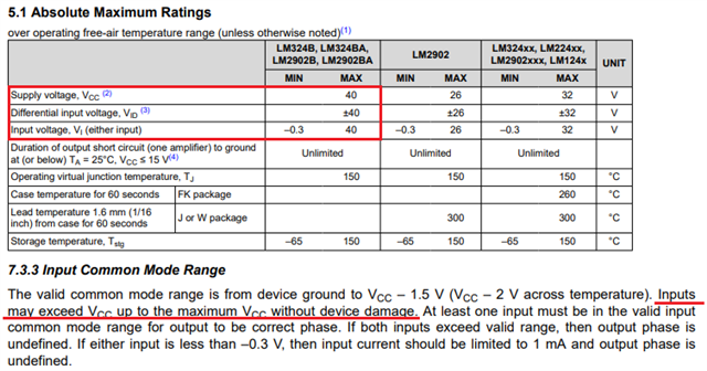

We notice that the ESD ratings of LM2904B improved to 2kV, does it add a ESD diode on output/input pin?

The LM2904B’s improved ESD spec (HBM ±2 kV; CDM ±1.5 kV) reflects different on-chip ESD structure and process improvement. The inputs have no internal ESD diodes at input pins to Vcc, which it can be seen from the abs. max. rating table.
At the output pin, I do not see that there are any ESD diodes described in LM2904B's datasheet. My guess is that the output stage may have ESD diode protection (since the output pin passed the ESD tests). If this is important to the customer, I can confirm it with designing engineers.
https://www.ti.com/lit/an/sloa277b/sloa277b.pdf?ts=1756956056835
If you have other questions, please let us know.

Thanks for your reply! Yes, please help confirm with design team. Customer may need to leverage this diode on Output to achieve some functions, thanks.
