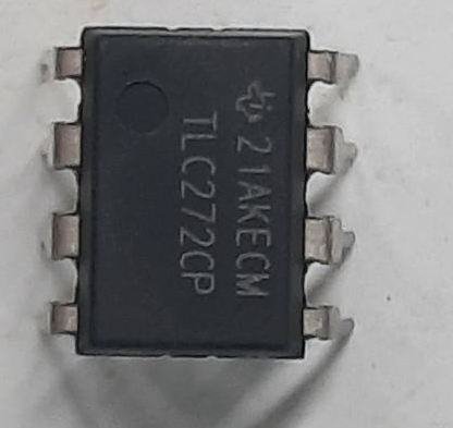

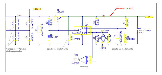

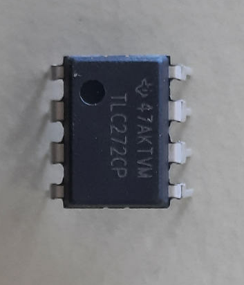

One of our customers purchased 500 units of TLC272CP and claimed due to following reason,
The following error pattern emerged:
- With the 15V power supply, only 1.9V instead of 15V is measured (see following)
- If the TLC272CP with production lot 47AKTVM is replaced with an IC from lot 21AKECM, the circuit works again as intended (15V = 15V)
- So far, the error has only occurred with ICs with the production lot 47AKTVM

Defective part
Functioning part

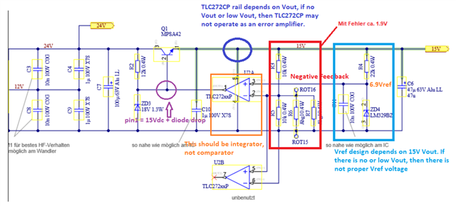

    I think that the circuit has several design issues to be addressed in addition to the op amp (see PCN link). The latest op amp has slight output characteristic vs. pre-PCN part and it will behave differently. But the issues are mainly from the design of series regulator, which has many issues, see the comments below. The post-PCN TLC272CP is a RRIO op amp; the pre-PCN TLC272CP is either RRI nor RRO op amp. The op amp was "working" because of the previous non RRO characteristics, which mask the proper design of the series regulator.
    In addition, PCN was issued in this part, that may explain why the other design issues are revealed in this case. And the date code in the part indicated that "defective" op amp (manufacture in July, 2024) is post-PCN type.
    https://mm.digikey.com/Volume0/opasdata/d220001/medias/docus/5388/PCN20230608002.1.pdf
    There is nothing wrong with the post-PCN TLC272 op amp for the application. You may have to re-spin the PCB design and fix all the design issues in the existing circuit. Please let us know how you would proceed.
