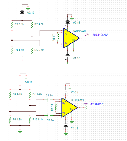

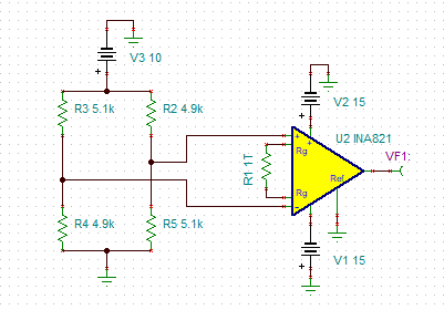

If using the INA821 with a 5k Ohm strain gauge bridge (10V excitation with 0V reference), is providing a path for the input bias current still required as shown in Figure 68 of the datasheet?
  • Hi Brian,
    Are you using the strain gauge bridge similar to the one below? If so, then that sufficiently provides return path for the bias current. Specifically, there must be a DC return path, which is provided by the direct connection to the bridge.
    You can actually use TINA-TI to simulate this. Below are two examples, the top with a DC return path, and the bottom without a DC return path. As you can see, the bias current of the bottom INA821 charges the input capacitors C1 and C2, forcing the output to saturate to -13V. The top INA821 does not have this issue, and shows a linear output of 200mV.
    Let me know if you have any other questions, or if you have a different design than the one I provided.
