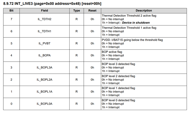

We’re working with the TAS2780 and using it as a DAC/amp, but we believe we’re not getting the maximum possible output volume.
Current configuration
  • CDS_MODE = 0x00 (Y-Bridge, High-Power on VBAT1S)
  • AMP_LVL = 0x14 (maximum analog gain)
  • DVC_LVL = 0x00 (no digital attenuation)
Observation
  • Measuring at the speaker outputs with an oscilloscope, the maximum voltage we see is approximately VBAT1S. This suggests the Y-Bridge is active, yet the acoustic level still seems lower than expected.
Questions
  1. Are there protection/limiter mechanisms (e.g., thermal, over-current, undervoltage/battery tracking, clip limiter, etc.) that could be engaging and reducing output? Which status/flag registers should we read to confirm?
  2. Are there other registers that can cap output level despite AMP_LVL max and DVC_LVL = 0x00?
  3. Any recommended checklist to verify we’re truly at maximum output?

    CDS_MODE = 0x00 and VBAT1S Mode = 0x0 will enable Y-bridge and allow maximum power from the output.
    AMP_LVL and DVC_LVL as 0x14 and 0x00 respectively is correct for the maximum output power
    I believe this issue is due to the way BOP is enabled inside our device registers
    we have a top-level control to enable and disable the BOP which is disabled by default. Book0 page0 register 0x1d (B0P0R0x1d) bit 1
    However, each of the 4 levels of BOP have a control to enable/disable, and if this enable is set(whch it is by default) i believe it will still have an effect even if the top level control is 'disabled'
    BOP_DIS3 - B0P0R0x23 - bit 4. set this register to 0x10 to disable
    BOP_DIS2 - B0P0R0x28 - bit 4. set this register to 0x10 to disable
    BOP_DIS1 - B0P0R0x2D - bit 4. set this register to 0x10 to disable
    BOP_DIS0 - B0P0R0x32 - bit 4. set this register to 0x10 to disable
    I suspect this is the reason for the limited output. apologies as i did not test this today before providing you the response. hopefully this is a quick test and you can let me know if the issue is resolved.
    Arthur
  • Also, you can verify if the BOP is active based on the LIVE interrupt register flags in B0P0R0x48
  • Thank you for your prompt and good answer, Arthur! I think that we are indeed getting the most that we can from the output.
    Playing around with the EVM, I disabled the BOP as you mentioned and configured everything the same to get the maximum power and we are getting the same output.
    Could you confirm that using the test tone is a good way to get the most power from the TAS2780?
