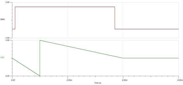

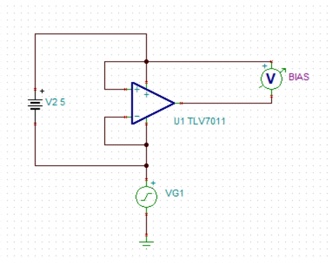

As you can see, the supply of TLV7011 is fixed to 5V, and by connecting the inputs IN+ and IN- to Vcc and Vee, respectively, will not violate the common-mode (though this is comparator, CM might not an issue).
No matter how the VG1 supply is changing [(0 to -5V @ 1ms), then (-5V to 5V @1ms)...with the set-up above, the output should always equal to Vcc.
Thus, expecting for the voltmeter (BIAS) to be always equal to zero (since Vout should be equal Vcc).
But the result is different:
Can you support this issue?

  • Hello Archie,
    The mode does a test. if is mentioned in the model's text.
    If the input or supply rail goes beyond the abs max limits, the output will float at mid supply
    * If one or both inputs go beyond the commmon mode limit, the output will float at mid supply
    The disconnect between ground and comparator seems to confuse this test.

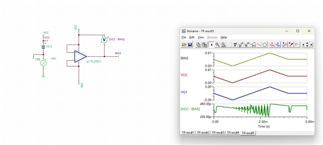

    7484.TLV7011_sim2.TSC
    Below is the sim:
    Still a little bit of weirdness with VCC - BIAS, but the output should track the VCC now that the supply range and input range blocks are functional.
    Please let me know if you face any issues with my changes. I'd try to look for issues myself, but it's quite difficult to do an extensive validation of the model after the changes since I'm unable to find an unflattened netlist for this model. I've been debugging through plotting the internal nodes through referencing the simulation with the .lib.
