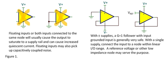

For TLV2197, if one of the two Op-Amps is not being used, how should the unused Op-Amp be connected? Should it's pins be grounded, or left floating, or something else?
Hi matti,
Here is the recommendation for terminating unused op amp. In any case, it is recommended to place unused op amp in a linear operating region, depending on the op amp's supply arrangement, see the attached image and link below.
If you have other questions, please let me know.
