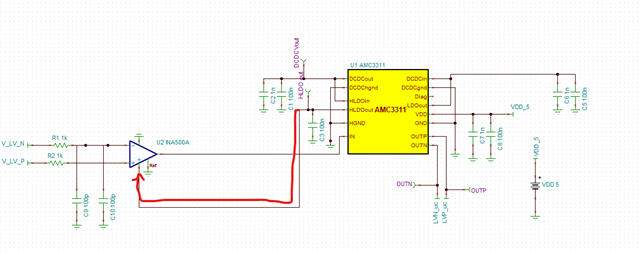

Is that ok to connect HLDO out to supply the INA500A? instead of connecting dedicated VCC to that. Please find the below image for more information. Requesting to insight on this.
Thanks and Regards,
Abdul
  • Hi Abdul,
    I'm not too familiar with the AMC3311, but from what I've seen in the datasheet, there appears to be enough quiescent current and of course output voltage needed to ensure steady operation of the INA500x.
    AMC3311 datasheet specs
