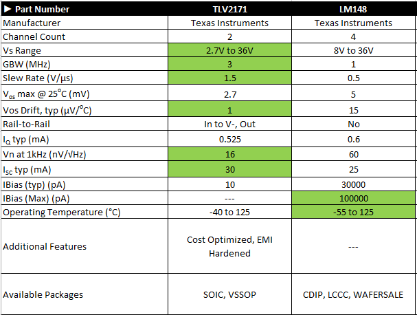

Can i use TLV2171 instead of LM148?
Hi Kaya,
I do not have any information about your application. Based on the comparison table below, TLV2171 may be used, except the low operating temperature. Please let us know what it your product temperature requirements.
If you have other questions, please let us know.
