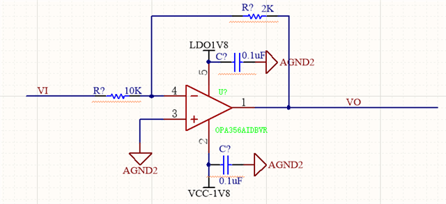

I want to use this amplifier to create a reverse proportional circuit for scaling the signal, as shown in the figure below.  The power supply is ±1.8V,The input signal is a 10 MHz sine wave, featuring an amplitude of ±50V and lasting for 20μs, followed an amplitude of ±5V also lasting for 20μs, as shown in the figure below. This pattern repeats every second,  My objective is to scale down the ±5V signal to ±1V,and not need to pay attention to the period of ±50V,My question is the 20μs ±50V signal can damage the amplifier? Will prolonged repetition of this cycle cause any damage? thanks!

    The input of the OPA356 is diode clamped. So if you limit you current going into the input termimal below 10mA, it should not be a problem.
    In you case it will be less than 5.2mA (51.8V/10Kohm), so should be fine to use. It will not cause damage to the device.
