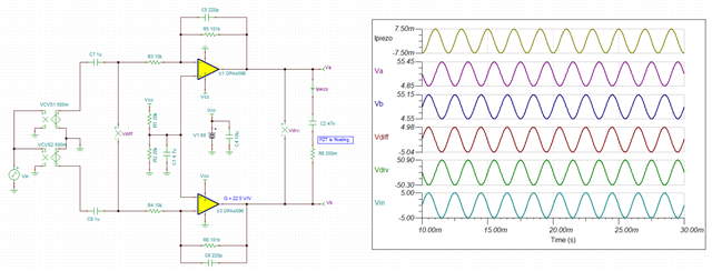

For example, is it possible to double the output amplitude by connecting a high-voltage op amp such as the OPA462 in series?
An example of a current amplification circuit with an output connected in parallel is provided.
I am considering whether it is possible to create a 300V 400kHz or 800kHz MEMS driver circuit using an op amp.

    To double the op amp's driving voltage, you may do in the following two topologies.
    1.  configure op amp in bootstrap supply‐rail driver technique
    https://www.ti.com/lit/an/sboa510/sboa510.pdf
    2. the following method is using push-pull driving topology to double the output voltage swing. In this example, I create the MEMS/PZT driver with OPA596. You need to configure your application with OPA462 instead.
    PZT 100Vpp Driver OPA596 09122025.TSC
    If you have other questions, please let us know.

  • Hi Hiroaki-san,
    To drive 300Vpp, you may need two of OPA462 HV op amps to drive MEMS actuators --> the similar driving push-pull driving topology as in OPA596/OPA2596.
    Most of MEMS actuators do not require to drive large level of current, so OPA462 should work generally. Do you have the equivalent PZT Spice model.
    The following image is a typical PZT/MEMS equivalent Spice model. If you have these figures, we can simulate the driver.
    I would like to refer to your application note, configure op amp in bootstrap supply‐rail driver technique,
    and a MEMS driver circuit using the OPA596 for advice.
    It is not clear what you are referring to here. OPA462 is rated at 180Vdc in a single supply rail. To achieve 300Vpp output swing at 300kHz, 400kHz or 800kHz, you would require to have a single supply rail that is greater than 150Vdc + OPA462's headroom to accomplish this (e.g., 160Vdc single supply rail).
