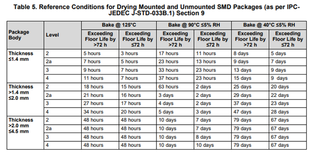

Please provide the Baking conditions for TLV9154IPWR
Hi Sa,
Here MSL rating chart and controlled environment storage conditions.
Here are Baking procedures and conditions.
/cfs-file/__key/communityserver-discussions-components-files/14/Baking-Procedure.pdf
If you have other questions, please let us know.
