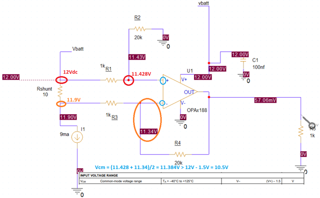

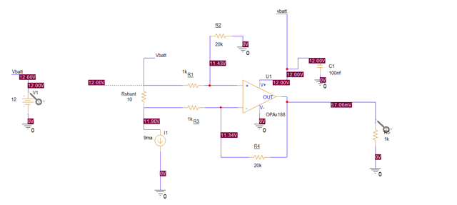

Hi :
I am trying to use the OPA188 as high side current sensor .
I am using the TI pspice but the output is not correct :
with Rshunt =10 , R4=R2= 20k , R1=R3=1k , Vout must be : 9ma x 10 x 20 = 1.2v hoever the output is 57.06mv when using bias point simulation .
am i missing something or it is an issue with PSpice for TI not able to simulate the opamp bias points properly ?
