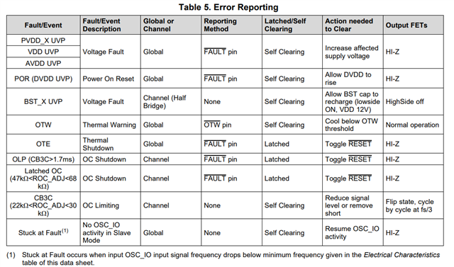

    Can you confirm if the reset works properly? The fault pin is pulled low but by activating the reset it will release the fault pin?
    Above are some of the faults that can be reported by the active low fault pin.
    If the fault is cleared after activating the reset, then it could be caused by an overcurrent shutdown or thermal shutdown.
    Also if you could probe the input/output during this scenario that would be helpful.
    Sebastian

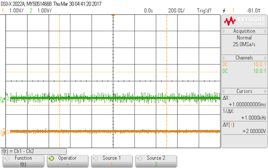

    I confirm that the reset works but the fault pin returns to zero instantly,
    it's probably not a thermal problem because the chip isn't hot at all,
    I also tried to remove the L1-4 inductances and it didn't change anything,
    Here are the results of my measurements, on the left the input signal INPUT_A and INPUT_B and on the right the output.
    Jonas
