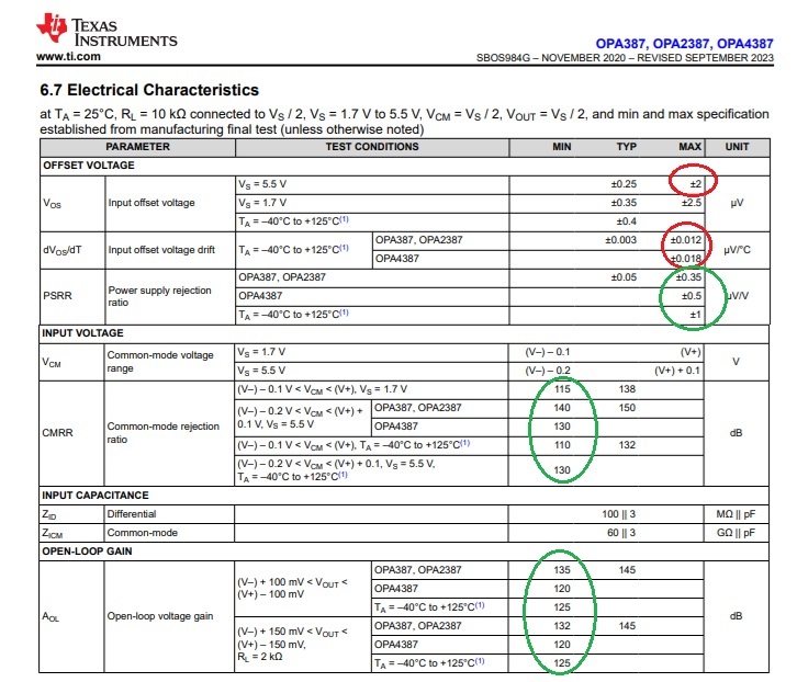

  • Furusawa-san,
    When it comes to op amps, following terms for various degrees of precision are being used:
    PRECISION - for parts with max input offset voltage (Vos) of less than +/-1mV and maxVos temperature drift of less than +/-2uV/C (typically laser trimmed)
    HIGH PRECISION - for parts with max Vos of +/-100uV and max temp drift of +/-1uV/C (typically e-trim)
    ULTRA-HIGH PRECISION -  for parts with max Vos of +/-10uV and max temp drift of +/-0.1uV/C (typically zero-drift - chopper or auto-zero)
    Please note that in case of ultra-high precision additional parameters like PSRR, CMRR and AOL are 120dB or higher (see in green circle below).
