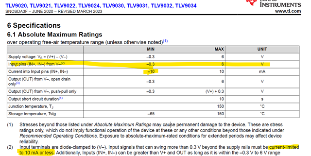

For our application, the (IN-) goes to about -700mV to -800mV. However due to our circuit configuration, the current though the (IN-) should be less than 10mA.
So is it ok that we are exceeding -300mV as per abs max if the current though (IN-) is limited below 10mA?

  • Yes, this will not damage the device.
    (When an input voltage is outside the recommended input voltage range, correct operation is not guaranteed.)
  • Hi Arturo,
    While it may not cause damage, there is the possibility of a false output if you go that low.
    As TI, we cannot condone violating the -0.3v specification  - so I cannot say -0.8V is okay. And I am not comfortable with -0.8V, as you are getting into reversal territory.
    Proper operation is only warrantied to -0.2V.
    This is a confusing spec as violating either 10mA or -0.3V violates the Abs max...so technically you cannot violate the 10mA without first violating the -0.3V limit. To get to 10mA, you need to be at almost -850mV.
    TI recommends using external clamping or attenuating to not violate the -0.3V, and limiting the current to less than 1mA.

  • Hi Paul,
    Just to confirm my understanding:
    If the IN- absolute limit is violated (e.g., goes below -0.3V) but the current is limited (say less than to 1mA), the device won’t be damaged. However, correct operation is not guaranteed — for example, the output may go high when it should be low, and vice versa. Is that accurate?
    Also, if the IN- voltage exceeds the absolute limit for part of the signal (e.g., half a period), but then returns to the recommended operating range for the remainder, would we expect normal operation during the time it's within spec, despite the earlier violation?
    I say this because we don't care about correct output during the time when the IN- abs max is being violated (exceeding -0.3V).
    Arturo
  • Hello Arturo,
    Correct. It will not be damaged but we cannot guarantee the output will be correct when below -0.3V.
    Correct. Worst case there may be a small "recovery time" when coming back into the operating range, slightly increasing the prop delay by a few dozen ns.
    TI cannot say it is okay to exceed -0.3V, so you will have to assume the slight design risk.
