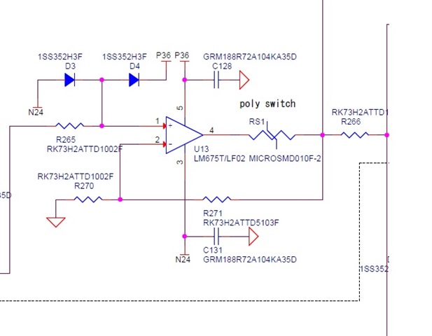

  • Hello Mr. Jacob Nogaj,
    A polyswitch has been placed at the output to provide a current limit of 100 mA.
    In addition, although there are ten identical circuits using the LM675, only this particular IC has failed.
    Please find attached the surrounding circuit of the LM675 for your reference.
    Please let us know if you also require the surrounding amplifier circuitry.
    Sincerely,
  • Hello Yamamoto-san,
    This is interesting to see. I like to see the polyswitch, this should offer some protection. The diodes on IN+ are also welcome.
    What value is R266? Is there any chance of a power sequencing being incorrect?
    I do not see any apparent issues in the schematic.
    Is ESD any risk in this design?
    Jacob
    Thank you very much for your response.
    The value of R266 is 10 Ω.
    We believe there are no issues with the power-up sequence.
    However, when the LM675 failed, the chip fuses located on the +33 V and −24 V supply lines were found to be blown. It is possible that these fuses may have opened prior to the failure of the LM675.
    There is no risk of ESD in this environment.
    We would greatly appreciate your further review and confirmation.
    Sincerely,
  • Yamamoto-san,
    Thank you for the details here. R266 should help limit current in fault state.
    I am unsure what caused failure here. Perhaps the chip fuses were blown, and then the amplifier had load current continue to pull from the output, causing over-voltage damage.
    Where does the supply power come from? Is this LDO powered? Were the fuses common to all of the power amplifiers, or just used for this one power amplifier?
    Good to know that ESD is not a concern here.
    Jacob
