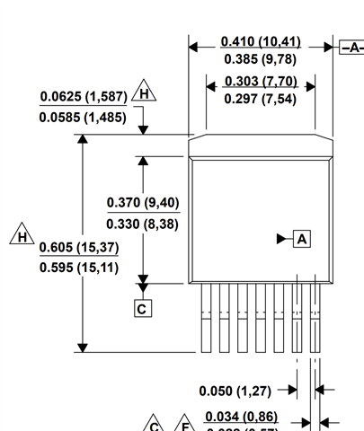

Could you please share the recommended land pattern for the part OPA547F/500?
We were unable to find this information in the datasheet. We’ve downloaded the relevant package from Ultra Librarian, but it provides three different decal options. Unfortunately, none of them match the mechanical dimensions specified in the datasheet.
To proceed with the PCB layout, could you please share the correct land pattern for this part?
Thanks in advance for your support.

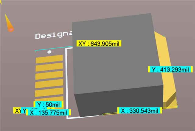

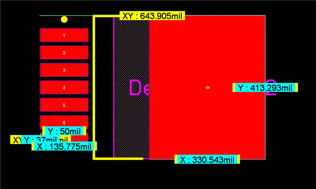

  • Hey lathanivetha,
    No problem. I know we were bouncing between ALM2402 and the OPA547. I can provide you with the landing pattern for designing with the OPA547F/500.
    Let me start by saying that some of these older parts have more options for landing pattern due to less uniformity across Burr Brown and TI.
    I know that the Ultra librarian footprint will facilitate the OPA547, and honestly I may prefer that landing pad over what I have in my vault.
    Here is my footprint for KTW7:
    The largest difference in my footprint vs. Ultra is the fact that my Y dimension on the thermal pad is a bit smaller relative to the top of the device pads.
    It appears that my footprint also has taller pads relative to the Ultra model.
    Both footprints will work perfectly fine.

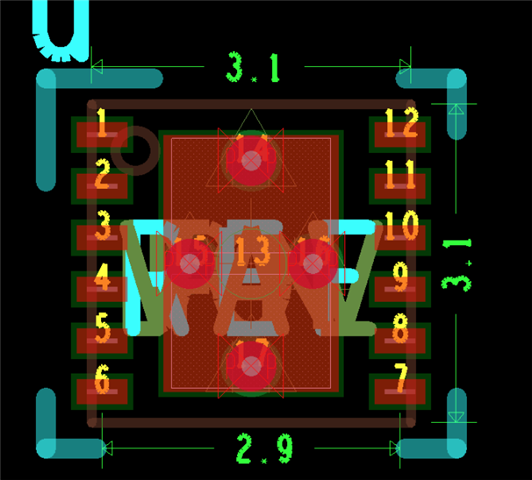

    Additionally, could you please share the recommended land pattern for the ALM2402QDRRRQ1 IC?
    We've noticed a discrepancy between the WSON-12 package dimensions listed in the datasheet (3 × 3 mm, 0.5 mm pitch) and the decal provided in Ultra Librarian. The assembly value differs between both.

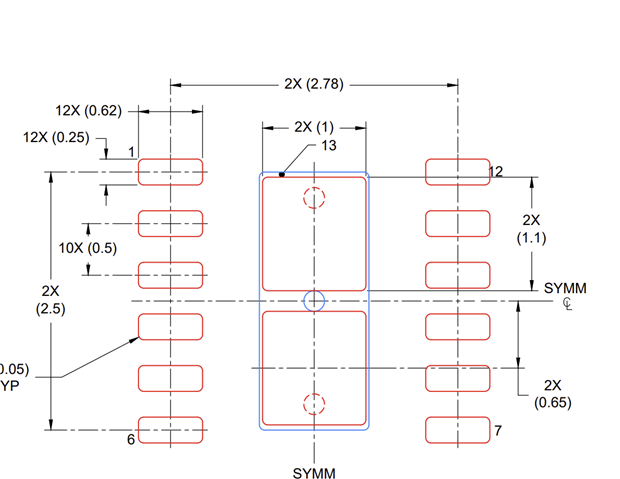

    Here is my footprint for the ALM2402 device:
    Here is the footprint which should have been included in the DS:
    Both are valid implementations. Personally, I prefer the style used in my Altium, which should be the same as what Ultra has used.
    What had a disparity in your eyes? the 3.1mm outside package dimensions can be understood as the max dimensions for the DRR package.
    Jacob

    Assembly and Pad values are available. But we required mechanical dimensions also, could you please share the same for ALM2402-Q1.
  • Typical package dimensions for DRR12 are 3mm x 3mm. this can be +-.1mm max. Are there any other dimensions you require?
