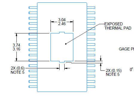

DRV595 datasheet shows two different components under the same TI P/N
DAP:
DAP0032C:
Exposed pad size is different and might required different solder paste mask.
Please correct the datasheet.

Hi
I'll review your inputs and get back to you tomorrow
-Ivan Salazar
Applications Engineer
DAP0032C is the latest one, it will be better to refer the latest land patterns.
We'll take note to remove the older mechanical information during data sheet review.
