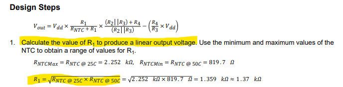

  • Dear  ,
    Thank you for your immediate response. You state that this method for calculating R1 is "not for linearity".
    I'd like to point out that your statement is contrary to what TI's own design specification asserts, see for example SBOA323A from "CIRCUIT060002
    Temperature sensing with NTC thermistor circuit":
    Could you please add you perspective on this apparent contradiction?
    Please note that I understand that the response of RNTC(T) is highly non-linear. So no matter what you do regarding resistor R1 (or any other more complex resistor network), you can only minimize the error of the response compared to a linear approximation over a limited temperature range, but you cannot make the response truly linear.

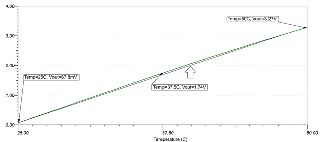

  • Daniel.
    Noted. You also understand that a resistor (Bot & Top) voltage divider. Vout = VIN * B / (B+T) has an inverse element control that has very limited ability to correct a highly non linear input. The op amp U1 does a linear transfer Vout = m * Vin +b (a line)
    SBOA323A is a linear in the fact that it isn't digital. The result curves look linear until I use paint to add a pixel line. Clearly green curve and black line diverge.
