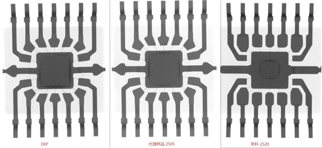

The sizes of internal wafers of the same model are different.Has the internal structure of this model undergone any changes?
Yes, TI has moved the die to a new fab with improved geometry, giving a smaller die. The PCN can be found here:
https://www.mouser.com/PCN/Texas_Instruments_PCN_20241119003_1_Change_Notification.pdf
