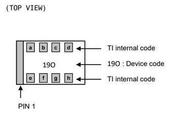

Part Number: TLV7021
Hi team,
Can you please share the information of TI internal code info of sympol such as fab, AT, date,...,etc?

Hello Hayashi-san,
a-d is last digit of year assembled. 1 is only d dash. 9 is a & d. 0 uses 10 , a & c
e-h is is month assembled. January (1) only d dash. Dec (12) is e & f
19O plus being DCK makes it TLV7021
Check original shipping / reel labels for more information.
