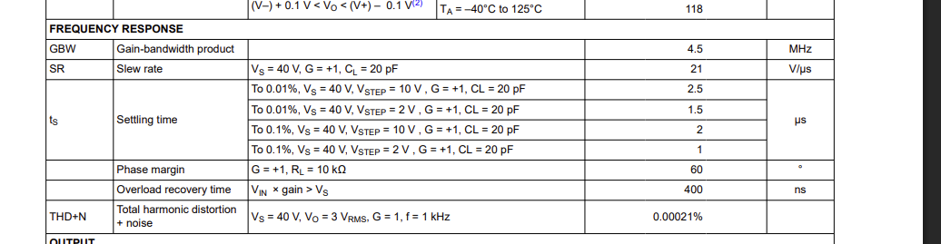

How would I calculate the maximum settling time for Vs= 24V (or +12V, -12V), Vstep= 10V, G=+1, CL to 20pF and to 0.1%?

Chang,
The settling time given in the table is a typical value. For a 0.1% settling time with Vs = 40V, Vstep = 10V, G=+1, and CL = 20pF the typical settling is 2us. This is the average settling for a population. Typically most parameters like this will very +/-20% to +/-30% worst case. So, you can estimate the maximum as 1.3*2us = 2.6us. Your question askes for the same test conditions with a different power supply. The supply voltage will not have a significant impact, so the 2.6us is reasonable. Note that load capacitance, step size, and gain values will have a significant impact, so if you adjust these conditions the worst case will be different. To check typical settling for different test conditions simulation can be used.
best regards, Art
