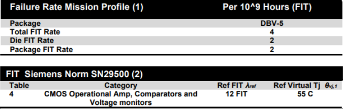

Could you please share the Functional Safety FIT Rate and FMD document of TLV316-Q1? Thanks.
Here are the Fit Rate values for TLV316-Q1

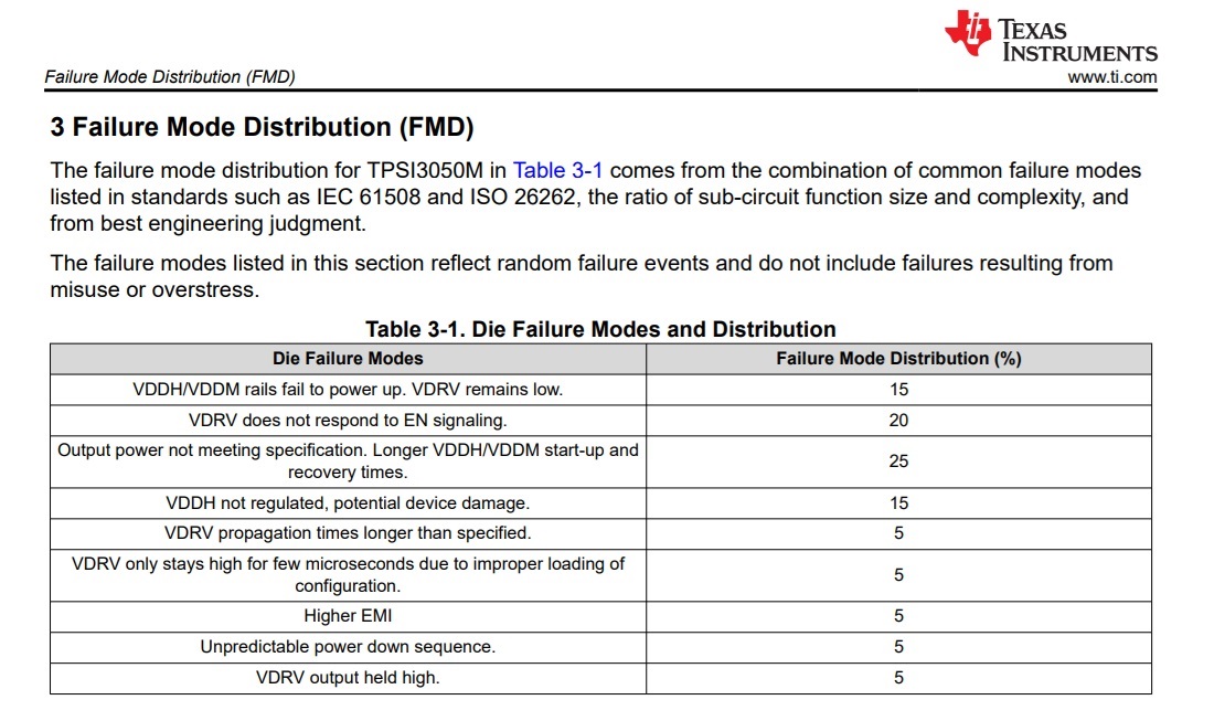

Thank you for your response. By any chance, would it be possible to obtain data on the failure mode distribution (FMD) as well?
Below please see table of Failure Mode Distribution (FMD).
