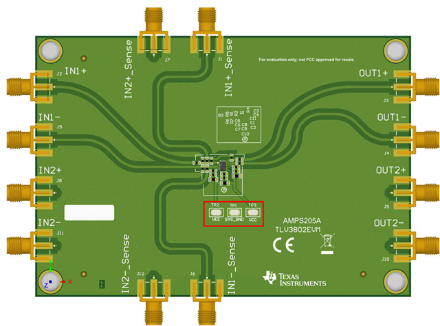

What are the dimensions of the TLV3802EVM board?
Hello Francisco,
The SMA connector width is 0.375". In my image, this is 136 pixels(black lines).
Board X is 1798 pixel; so 1798/136 * 0.375" = 4.96" approximate
Board Y is 1798 pixel; so 1245/136 * 0.375" = 3.43" approximate
Not counting SMA overhang
Hi Francisco,
The board is 4.75" x 3.250" (pretty good guesstimation, Ron!)
#4-40 Mounting holes/standoffs are 0.2" from the edges.
