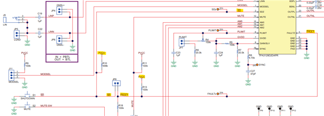

My second question is about part 7.3.10 Short-Circuit Protection and Automatic Recovery Feature which says I can achieve automatic recovery by directly connecting SDZ and FAULTZ. My question is where should that connection be? And can I similarly pull up FAULTZ with avcc?

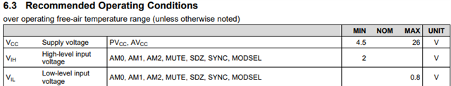

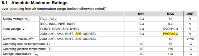

    1. TTL logic refers to transistor-transistor logic levels, where typically a 5V supply is used. 2V to 5V would be considered a high, and 0 to 0.8V would be considered low.
    In this case the SDZ can be pulled up as high as the PVCC voltage. Since the SDZ needs to be pulled high to enable the outputs, tying it to PVCC or AVCC is a simple way to pull the SDZ pin high. You can tie to AVCC using a resistor such as 499kOhm.
    2. Here's a snippet from the TPA3129D2EVM. There's a jumper to tie the SD and FAULTZ pins together, both are pulled up to PVCC but you can pull up to AVCC as well.
    3. I think this is a mistake in the schematic, GVDD is an internally generated voltage supply so I wouldn't recommend loading it as mentioned in the pin description. I would pull up SDZ, FAULT, and MUTE pins to PVCC or AVCC.
