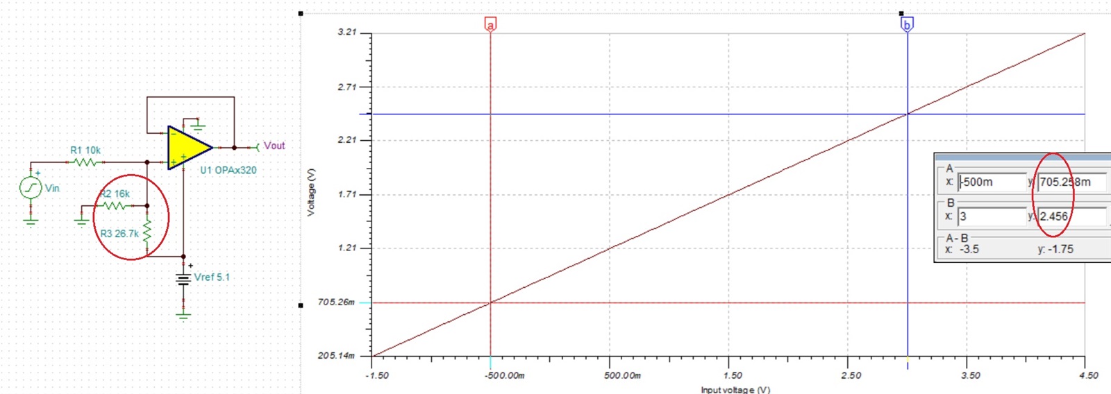

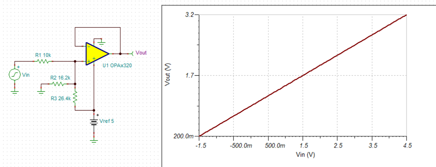

  • Assuming Vref=5V, the circuit meets the design parameters - see below.
    For Vref = 4.992V see plot below.
    Below I have attached Tina-TI schematic for your own simulation.
    OPA320 level shifter.TSC

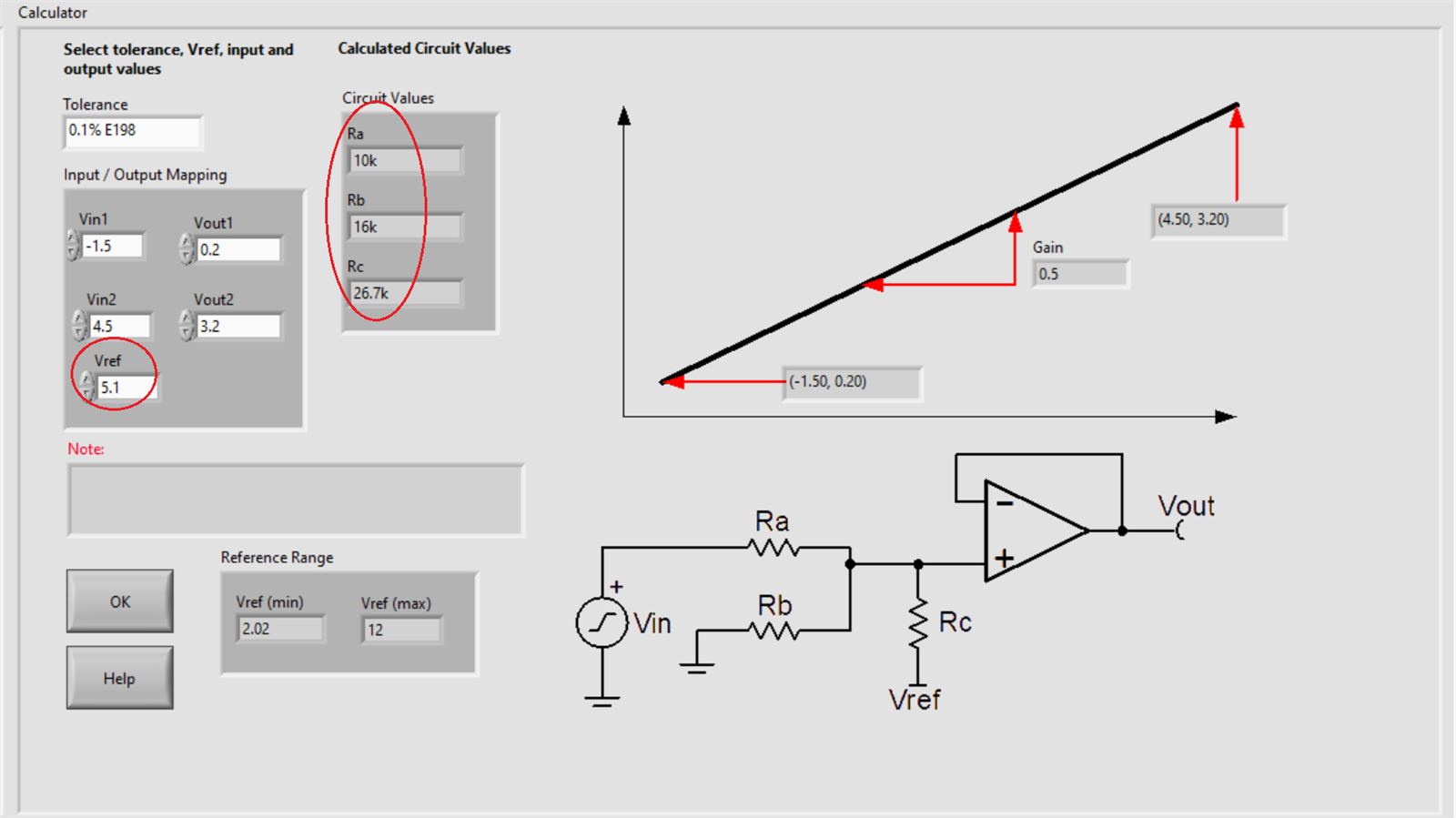

  • Dear Marek Lis
    I have compared the actual output values from the op-amp with those calculated by the tool, and I observed a discrepancy.

  • You seem to use wrong resistor values for Vref=5.1V - see below.

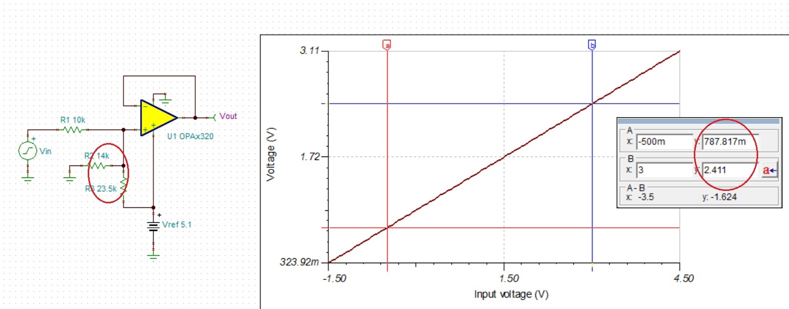

    Having said that I believe the main reason for the large error you see is the tolerance of the resistor you use. Calculating the gain using your values:
    Gain = (2.412-0.791V)/(3V+0.5V) = 0.463 instead of 0.5
    Thus, using R2 of 14k instead of 16k and R3 of 23.5k instead of 26.7k (~12% tolerance) would result in the error close to what you measure (see below):
  • Dear Marek Lis
    Thanks for your support, Now I am able to match my values
