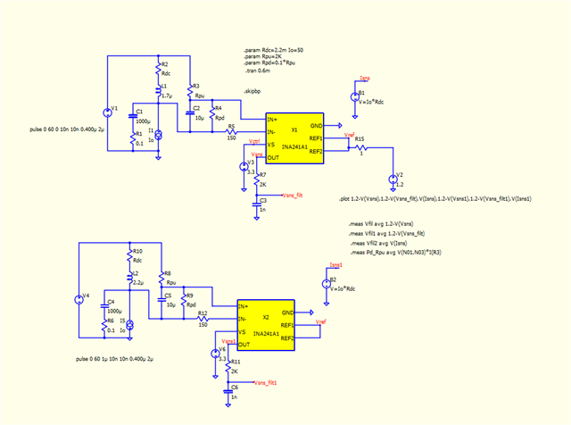

Currently using INA241A1 part to perform inductor DCR based current sensing for 48in/12Vo/250KHz 4PH interleaved GaN based buck converter application. 1.2V reference is supplied with external op-amp buffer.

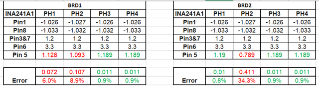

Seeing a big offset voltage issues at individual amplifier output and see similar performance too on multiple boards.  Initially everything looks good and over time the amplifier output voltage starts drifting with big offset. Circuit diagram and hardware reading for two different board attached.
Need help to understand the cause for this offset issue over time. Is this sometime to do with high dv/dt with GaN device or other issue?

    The test data seems to suggest that there is no inductor current. Under this quiescent condition, the problem unit output is way off. Is my understanding correct? Have you analyzed if these devices are possibly damaged?
    Guang
  • Yes just with bias supply turned on, we see offset issue at amplifier output. Analysis is not yet done, how to analysis for any possible damages on components as no physical damage observed ?

  • Test condition is 48Vin/12Vo/250KHz/30A and the amplifier inputs are always connected across sensing capacitors as shown in above. Once the offset issue occurs during switching/powering up, then the output of amplifier have this offset with or without powering on.

    Am I reading the table correct that pin 1 and 8 show about -1V to ground? Shouldn’t it be about 12V?
    Guang
  • Hi Guang, The table is readings with auxiliary power only after the offset issue occurring during powering on. Yes the capacitor one end is electrically connected to Vo(+12V). Could you explain the cause of this big offset reading?
  • Hi Raju,
    It is still not clear to me how the input pins were measured -1V. If both INA input pins are connected to 12V, the offset should be within spec (ie small). Granted with some resistors, the offset will be slightly bigger.
    If you have a socket, you can verify the device offset directly. However the phenomenon you described doesn’t ring a bell assuming there is no issue with test setup. I don’t have an explanation for it, unless the device got damaged. An electrical test should be able to test if the device is damaged.
