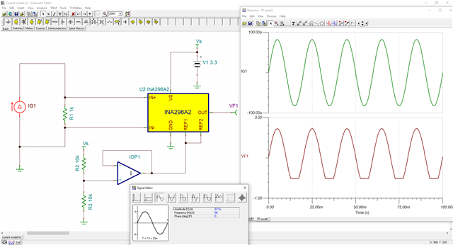

The application is required to measure a bidirectional current in the range of +/-80uA. We tried the following setup in TINA-TI, but the output waveform is being clipped off for the negative half cycle. Perhaps, the INA296 may not be the right device for this application. Please advise.
The common mode voltage is specified to be in the range of +/-75V.
