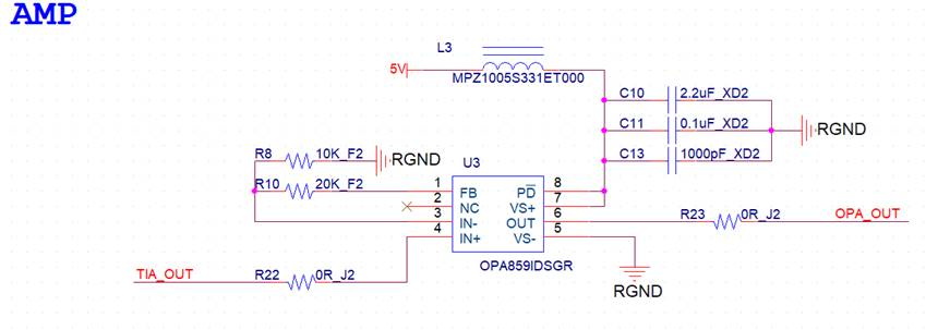

Hi Team,
Please help to check design below is OK or not?
Customer wants to design a noninverting amplifier, and the TIA_OUT signal is 0~1.4V with 100KHz, the output is 0~3.3V
Any modification suggestion is appreciated.
Thanks.
  • Hi Sir,
    Any comments for the question?
  • Hello Peter,
      We apologize for missing your thread. There are no issues in schematic. However, two comments:
    • Datasheet recommends to set feedback value to 150 ohms and adjust Rg for gain: “When configuring the OPA859 as a noninverting amplifier in gains less than 3 V/V, set RF = 150 Ω. When configuring the OPA859 as a noninverting amplifier in gains of 4 V/V and greater, set RF = 453 Ω.”
    • If max input is 1.4V, then max output voltage is 4.2V due to 3V/V gain configuration. Amplifier will be saturated at 4.1V. To avoid, can lower gain to 2V/V or 2.9V/V.
