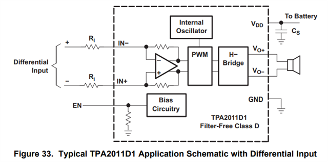

Hey,
I am working with TI’s TPA2011D1 amplifier. In the datasheet, the application diagram shows the positive differential input connected to the IN- pin and the negative input connected to the IN+ pin. I also noticed that there is an H-bridge inside the amplifier. My guess is that this H-bridge swaps the polarity at the output. Is my assumption incorrect?
