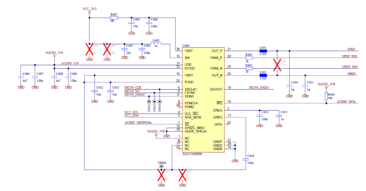

We are working with a system using the QCS8550 chipset and TAS2563 amplifier, connected as shown in the attached schematic. I2S has been used for audio data transfer and I2C for the amplifier control.
Note:
  • Vdd and IO supply = 1.8V
  • VBat supply = 3.3V
We have pulled up the I2C, interrupt, and shutdown lines at the processor side.

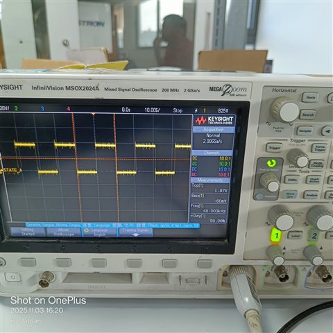

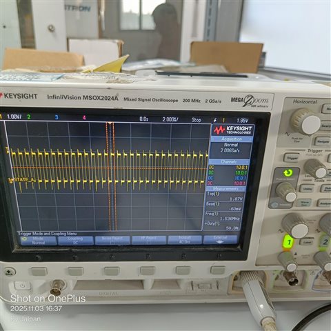

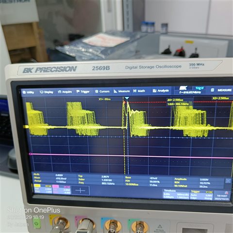

  • Hi Sebastian,
    We are using the CDS-40288 speaker, with load impedance 8 Ohm (CDS-40288 Same Sky (Formerly CUI Devices) | Audio Products | DigiKey).
    We have captured the output waveforms as show below. The amplifier settings followed were:
    1. We generated Sine wave of 48kHz using the audacity tool, and provided that as the input file for the amplifier.
    2. We have set the AMP_LEVEL value to 0x10 (from datasheet, 10h = 16.0 dBV (8.92 Vpk))
    3. We have set the Volume registers DVC_CFG1-4 to 0x40000000 (corresponding to 0dB unity gain).
    The above image was taken, when the audio file for the Sine wave was playing. As observed, the output, is not a clear sine wave. The zoomed version of the same is given below. The output amplitude is coming around 7V peak-peak.
    The above image is taken when the audio is about to be stopped.
    The schematics of the amplifier was already shared. Also sharing the speaker connection diagram.
    Please let us know if any other information is needed from our side.

  • Hi Kavita,
    Can you share your I2S signal clock frequencies (FCLK/LRCLK and SBCLK) and your slot/word length?
    I want to make sure these are in supported format. Can you also share your I2C script?
    If the audio data is in a supported format, a sine wave output should not be this distorted.
    Also I assume there is no filter on the output?
    I woud recommend using one to remove the switching component from the PWM output of a Class-D amplifier and get a clean output waveform.
    RC Filter Box For Class-D Output Power and THD+N Measurement
    Sebastian

    I2C probe is also working fine now. i2c get/set commands are functional. Tinymix command to control volume is working well - the values written to the registers are the same when we read it back via i2cget.
    Without changing any register configurations and using the default values: 0x20 for AMP LEVEL (0x03) register value, and 0dB (0x40000000), for the DVC_CFG1-4 registers. We tried playing a .wav file, but no sound is coming on the speakers.
    Observations:
    • BCLK: 1.5 MHz
    • Word clock: 48 kHz
    • I²S SD0: Data present during playback
    • Speaker output: No activity

    Thank you for the help. On playing the .wav files, it is audible over the speakers.
    However, we find that even on setting the max gain (value 0x1C in the AMP_LEVEL bits) and setting the highest volume possible via the tinymix command, we feel that the speaker output does not reach its expected maximum loudness.
    Speakers that we have tried:
    CMS-151125-18S-X8 Same Sky (Formerly CUI Devices) | Audio Products | DigiKey
    Speaker connection:
    Any idea what could be the issue?
