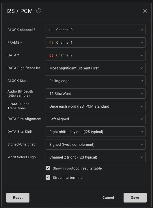

I'm sending data to the TAS2110 on the SDIN pin.
I noticed PPC3 did not export the TDM configuration (TDM_CG)
I intend to use PCM/I2S left justified, single channel , tho I output L and R each frame cycle.
I added these registers to the list.
{ 0x07, 0x03 }, // RX justfigy left, RX_OFFSET = 1
{ 0x08, 0x00 }, // RX stereo downmix, 16 bit word, 16 bit slot length
Looking on the wire, the data looks right.
The audio does not resemble an audible tone and sounds garbled.
Any advice for debugging this?
I'm using zephyr 3.5.0 and here are my settings
i2s_cfg.word_size = 16U;
i2s_cfg.channels = 2U;
i2s_cfg.format = I2S_FMT_DATA_FORMAT_PCM_SHORT | I2S_FMT_DATA_FORMAT_LEFT_JUSTIFIED;
i2s_cfg.frame_clk_freq = 48000;
i2s_cfg.block_size = BLOCK_SIZE;
i2s_cfg.timeout = 2000;
i2s_cfg.options = I2S_OPT_FRAME_CLK_MASTER | I2S_OPT_BIT_CLK_MASTER;

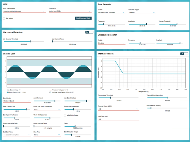

  • Hi Michael,
    Do you have any device control features enabled such as brown out protection or low EMI spectrum spread? If the device is receiving the proper data/clocks, perhaps one of these features could be affecting the output signal quality.
    Sebastian
  • Thanks Sebastian.
    Looks like they were both on by default.
    I just shut them off and getting the same result.
    tho for the first time, I've gotten audio on my macbook and windows machine.
    I will keep poking.
    I've attached GUI screen shots.

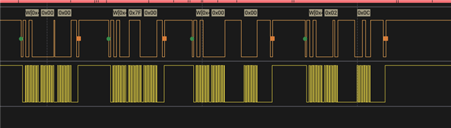

  • Here's what I notice. with xmos as a sound device, it only works when I power on from PPC3.
    Using the i2c logger with PPC3, I get the following 3 sequences when I go power on -> off -> on.
    w 98 00 00
    w 98 7f 00
    w 98 00 00
    w 98 02 0c
    w 98 00 00
    w 98 7f 00
    w 98 00 00
    w 98 02 0e
    w 98 00 00
    w 98 7f 00
    w 98 00 00
    w 98 02 0c
    I added that with my config, still getting distorted audio.
    Should I disable the thermal stuff as well?
    I also realized I needed i2c pullups, so that's looking much better.
    When I push my full config, I'm seeing alot of clock stretching
    zoomed in, register 0x5b
    this is my config loop at the bottom of this file, I added 5 ms delays between attempts, and 10 ms delay before retry
    this is triggered after I have timers filling the i2s buffer from a small state machine in a while loop.

  • Plotting the i2s data on the wire, I can see my wave form and what I believe to be outliers from the logic probe/wires.
    Even with those deviations, I would expect to hear some parts of the sine wave with noise.
