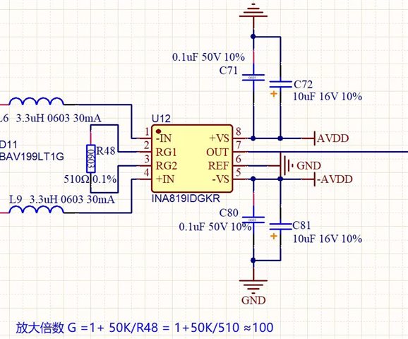

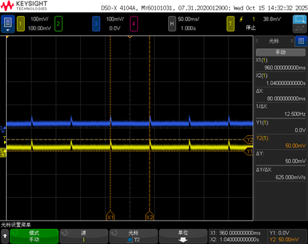

Hi Sir :
The input waveforms and peak values of the normal and abnormal modules are the same, but the peak value of the output waveform of the abnormal module is approximately three times that of the normal module, and the amplification factor is greater than the normal value, resulting in abnormal flow in the calibration mode of the module ;
Normal :
Abnorml :
