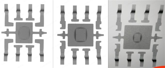

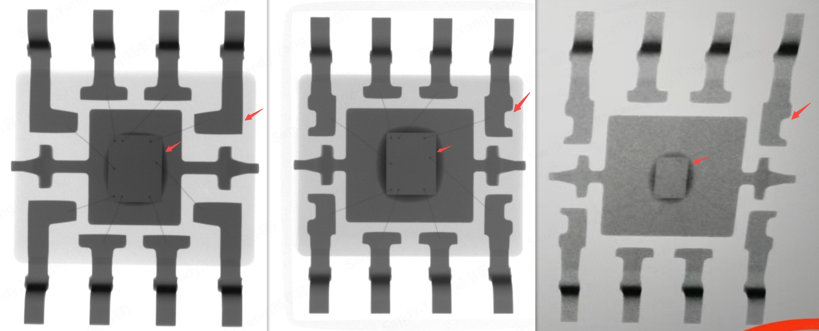

I recently performed X-Ray inspections on different lots of TI part number LM2904QDRQ1. Devices from three distinct date codes show obvious differences in both lead-frame geometry and die size:
  • Lead-frame structures vary slightly (e.g., lead pitch, internal bonding style).
  • Die dimensions are not identical; some lots have noticeably smaller dies.
  • Exterior packages look normal; after decap, one unit displayed TI markings, confirming it is genuine.
Could you please advise:
  1. Are these lead-frame and die-size variations within the scope of normal manufacturing changes?
  2. Has any Product Change Notification (PCN) been issued for these modifications?
Thank you!
