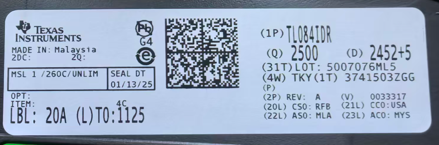

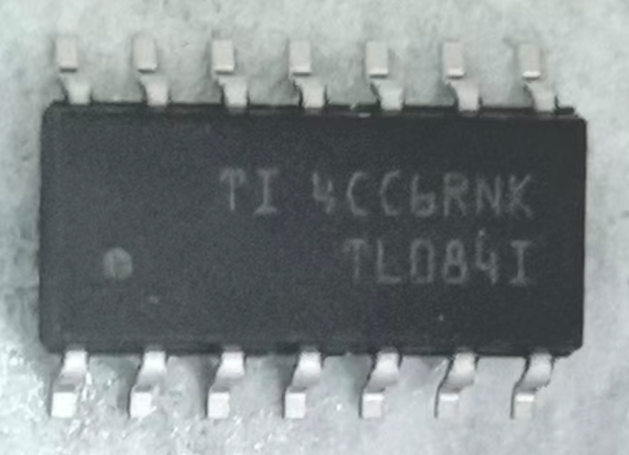

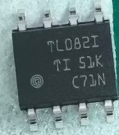

The quality flowmeter product uses TL082IDR and TL084IDR operational amplifiers, and there are issues with a single batch of products. Operational amplifiers can affect the 3.3V power supply of the system, causing voltage fluctuations between 2.8V-3.3V. There is no problem switching to other batches of products. Different batches of chips have different silk screen printing. The operating voltage of the operational amplifier is+/-9V, and both 3.3V and+/-9V voltages are converted using 5V voltage. 502 chips were soldered separately, but all had related issues. The chip label is shown in the following figure. Please help analyze the cause. Thanks.

    The date code for the TL082IDR problem chip is 2504, while the date code for a normal chip is 2226.
    The date code for the TL084IDR problem chip is 2452, while the date code for a normal chip is 2312.

    Ok, those are likely new die for the new date code.  The PCN below describes that the TL082 would be moving to a new fab:
    https://www.mouser.com/PCN/Texas_Instruments_PCN20220615003_20220616135610237.pdf
    There are some minor differences in the die; the data sheet describes most of them (the "H" die is the new die in the data sheet, both the old and new die performance differences are listed in the data sheet).
    The only other difference not mentioned in the data sheet is the ESD cells on the input  The old die did not have an ESD cell to the positive supply, see below:
