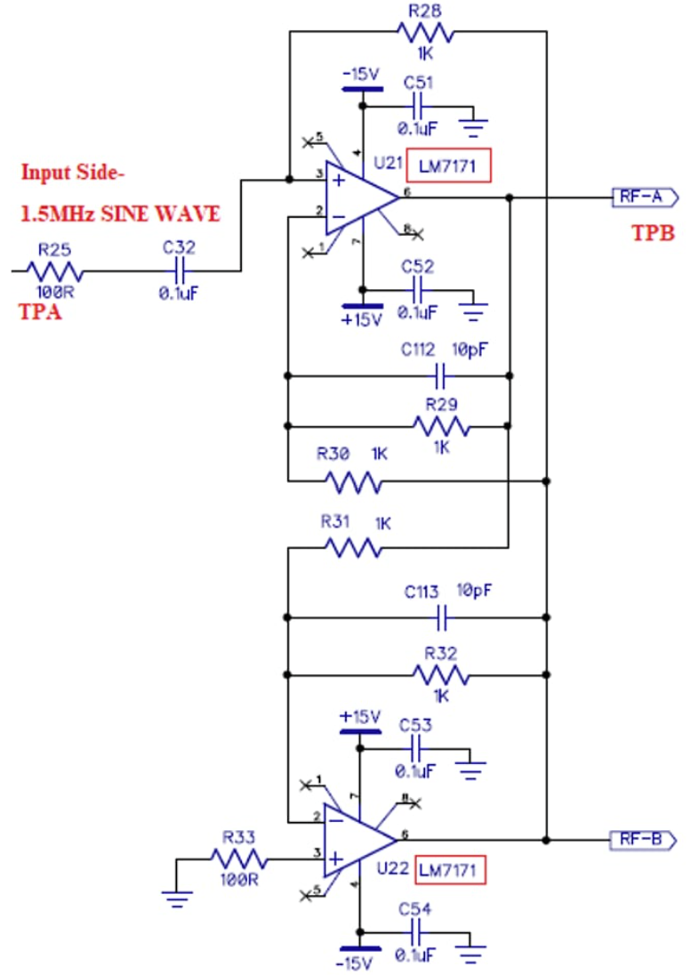

customer use our LM7171B for RF amplifier for 1.5MHz input sine wave,
and expect for  voltage sinwave larger than ex. +-5V , they expected output will stops as input stops,
but they found out in some pcs of sample , the output will keep oscillating, and we did a FA analysis show those sample came from same lot.
so just want you guy to help us simulate with LM7171B corner case (min and max) for their system below with TINA or PSPICE to see if there's really a margin risk in this design.
monte-carlo works as well , BTW .
previous FA report QEM-CCR-2508-00719 Final Report (TNI).pdf

  • Hi Fred,

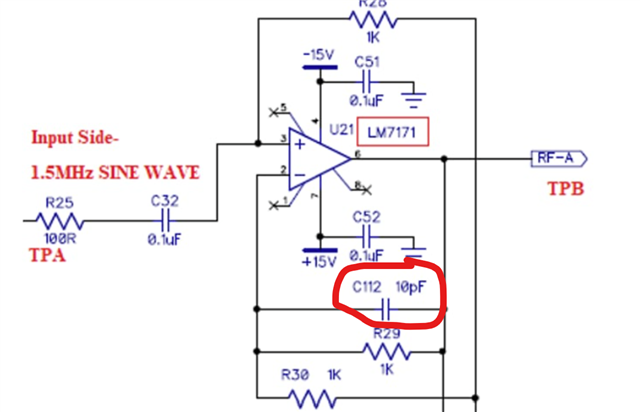

    This is not something we could capture. Our models are not designed to adjust a value without basically redoing the whole model for any variation you could see in the real device. The concern I see with this circuit is the feedback capacitance which could cause oscillations as it would ideally turn this circuit into a buffer at higher frequencies. This device is not stable in a gain of 1V/V, which this feedback capacitor will cause at higher frequencies. Could the customer remove these feedback capacitors and see if the oscillation goes away.
    Ignacio
  • Hi Ignacio,
    is there a equation that could show the potential of this 10pF would bring stability ?
    to be honest, I don't know how they achieve negative feedback with R28 connect to positive input as well, hope you could help me clarify it more
  • Hi Fred,
    The concern with this feedback capacitor causing stability issues is because this device is not unity gain stable. At higher frequencies this capacitor will behave like a short and will effectively turn this circuit into a buffer at higher frequencies. The image of the units that are working in their system would be useful to confirm what might be happening. The circuit itself is very interesting to get differential outputs, but I was able to get the expected results using a standard model in TINA. I was wondering if they have considered trying the LM6171, as this is a unity gain stable amplifier in the same family as the LM7171. There is also a dual version of the LM6171.
    Ignacio

    This device was designed to work in gains of 2V/V or better. The A and B version are the same core device. The LM6171 version is unity gain stable which should behave better with a feedback capacitor.
    Ignacio

    Goi it, but they said this medical design has been used and fixed for more than 7 years with LM717B without abnormal until recently, not sure if this give you more clue on quality perspective.
    On the other hand , this design was not meant for unity buffer , they did want to amplifier the 1.5MHz sinewave instead of buffering, and the feedback capacitor was for stability , does it make sense to you? And is it ok they change to use LM7171A on this design from now?
