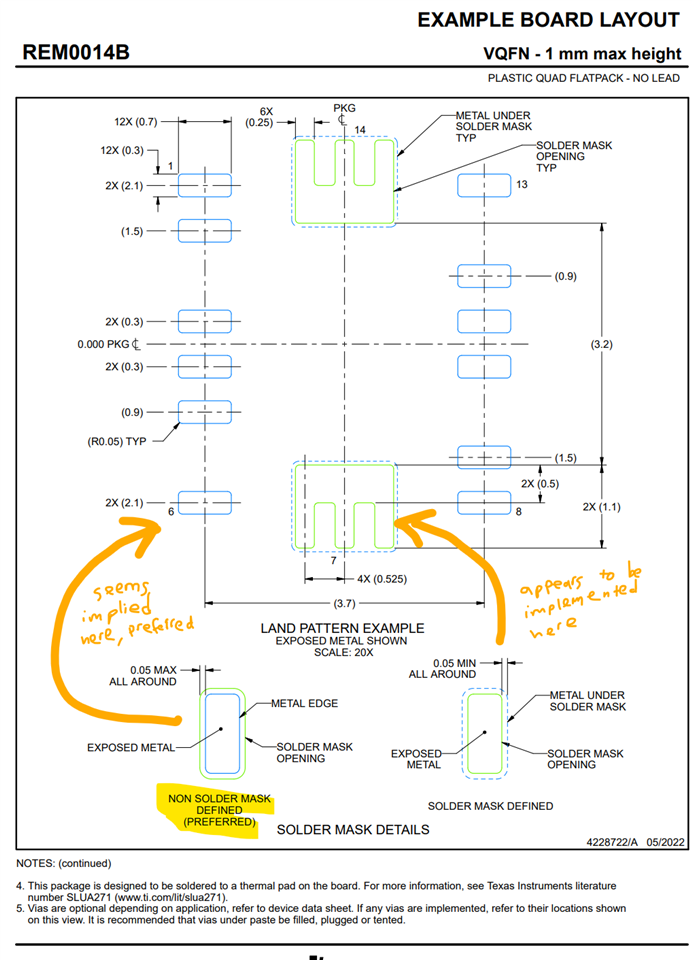

Hi Team,
Posting on behalf of our customer.
This datasheet appears to prefer a mixed solder mask styles of solder mask defined and non soldermask defined. is this correct? my team is looking for confirmation to clarify this so we get the best results in manufacturing and performance. thank you so much for your help!
