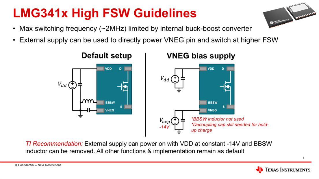

Specifications: Switching (gate control) ~10MHz (higher is better), Drain Voltage: 150V or higher, Power Consumption: 200W or higher. It is not intended for continuous use. It is used approximately 30 times, with 10 cycles per second.
I'm reviewing the LMG3410R070 part and wondering if it would meet my specifications. I need to have switching control at 10MHz.
